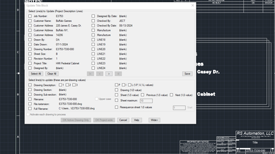

When I import the excel file back into the project, the drawing numbers still are the same even after changing them in the SHDWGNAM column. Is this because i used a .wdt file for my title block? I would really love to use this method to change drawing sheet number. The only other way that may or may not be possible is to have two sheet numbers that change with %S. Is that even possible?

rhesusminus
When importing back from Excel, AcadE will only change the variables inside the "settings" of the drawing. You'll need to run the Title Block Update to push those values into the title blocks.

deandrze
Currently, using our title block I can change the Drawing Number of every sheet, but only to the same drawing number. I think this is because of the .wdp file. But when I import back from excel and run the title block update, I only have the old option to change every sheet to the same drawing number.
The drawing number above is constant despite the excel file import, even doing the title block update anyways still only gives the same number
Message 10 of 11
rhesusminus
Checking the "Drawing (%D)" checkbox should update the value in the title block is it is mapped to an attribute in the title block.

deandrze
Thank you! that %D works, all I had to do was map the drawing number attribute to the %D
