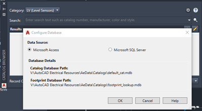

We recently upgraded to ACE 2020. I am having a strange issue where my default catalog database path is reverting to the old network location. Same thing for the footprint database. I understand how to setup the wd.env file for the projects and I have updated the project settings to have the new path in the project settings.

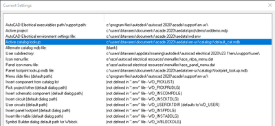

Here are my project settings. The default catalog and footprint catalog should be pulling from my E:\ drive for the active project.
If I pull up the catalog browser it takes an eternity to load because it is trying to load from the previous location. When if does finally load, looking at the properties, the path is the old path.

Also, if I change the wd.env file to the stock one that comes with the installation that pulls from the C:\ drive locally, the default catalog location is still being pulled from the old V:\ drive. I am a little confused how this can happen. All other settings for the menu files seem to work. It's the catalog database files that seem stuck to the old file location.

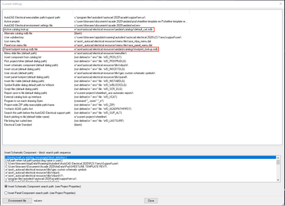

AS per the project setting, wd.env is in .....2020\aedata folder. Modify that wd.env file as shown below: Also check project setting as per the screenshot below. Then restart acade.

Remove comma and text after catalog as shown below. If still doesnt work, can you resend the project setting screenshot?

Here I switched to the out of the box wd.env file and looked at the project settings. default_cat.mdb should now be pulled form my local HDD.
Opening the catalog browser and looking at the settings this is not the case.
There has to be another location this information is being stored. Where is this location?

I think I narrowed down what the root cause. It has to do with the support file search path. I am setting the top 3 paths to search to my E:\ drive location first. When this happens, the catalog defaults to the V:\ drive. Why I don't understand. But, the menu files are pulling from the E:\ drive. This is a strange issue.

ramesh.kambang
Can remove first line marked in RED only? keep the rest (x2) for PLC and Catalog

I am connected to my companies network via a VPN. I copied all of the files that were on the network share V:\ to my local E:\ drive to speed things up. I am the only one working remotely so I wanted to set up all my files locally so I wouldn't need to go over the VPN. The rest of the designers work from the V:\ drive in the office. I will periodically copy the files from the network to my local drives between projects to stay up to date.
My wd.env file is local on my C:\ drive.
First borrowing a license from the server, I then disconnected from the VPN. I then added the 3 entries into the support file search path. I can't reproduce the problem. The catalog was being pulled from my E:\ drive. Multiple shutdowns and restarts of the application. That's great but I need to be connected to the VPN all the time for the other network shares I need access to as well as a license for ACE.
I then reconnected to the VPN and returned my license. I modified my support file search path with the one line you would like removed. Everything seemed to work after a few shutdowns of the application and reopening of ACE. I put the line back in as the top line and the catalog was back to the V:\ drive. Why? Seriously that is very strange.
So it looks like when the VPN is connected that this line
E:\ACE\AutoCAD Electrical Resources\AeData
it causes an issue and only reverts the catalog path to the previous V:\ drive. I removed the line again and things were working properly.
Not sure why this is happening. But it appears to be working now. Thank you for your help. This is a very strange problem.

ramesh.kambang
I believe, the first line folder contains wd.env file which is pointing to V drive for catalog. Even you dont have wd.env file in E dirve, when the vpn is  connected, acade loads your remote profile (it also depends on how your IT system is setup) and loads server wd.env file rather than the local ewd.env (you have modified and pointing to E drive).
As you need to be connected for network licence via vpn, I suggest to remove the first line completely or move it to the bottom so that acade always loads wd.env from your C: drive  first. This way acade loads and work much more faster especailly when you do the catalog lookup.

I am glad it is working, I believe it opens the catalog browser much faster when the first line is removed. Did you check the folder "E:\ACE\AutoCAD Electrical Resources\AeData" contains wd.env file? I guess yes, and that wd.env file is pointing to V drive for catalog lookup.

Message 17 of 21
You are correct. There was a wd.env file in that location. It was pointing to the V:\ drive. I was unaware that ACE would read in another wd.env file after the application starts. I thought it only read in the file from the local drive and then the project folder when the application starts. I learned something new today. Thank you for your help.
Message 18 of 21
ramesh.kambang
It will read that wd.env first because you have added first line - this means your telling acade to read wd.env from the first line folder first.
