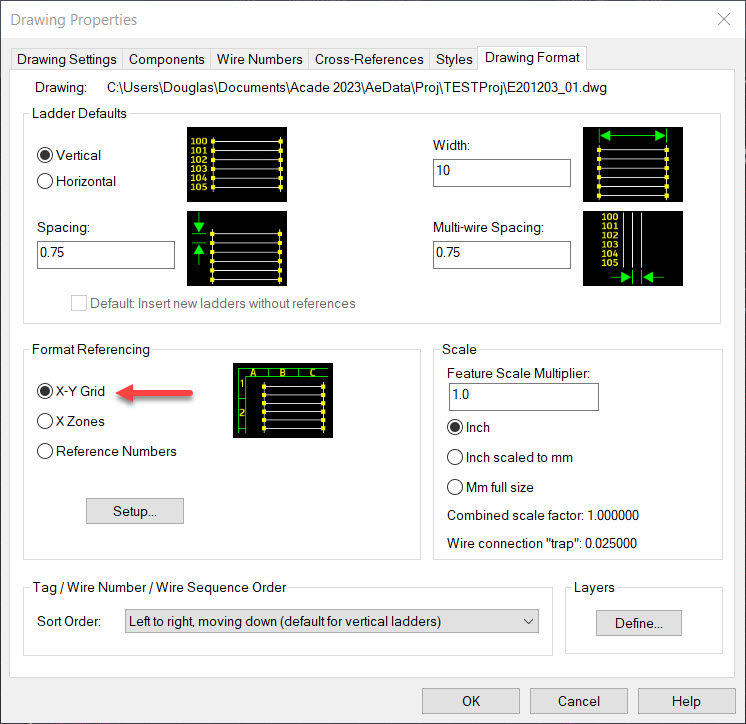

OH BOY? Potential customer as some unique drawing requirements:
Is this possible? Wire numbering (Alphanumeric)
           - first set of 2 digits will have equipment designation
                        *first 2 digits will be assigned by customer)
           - second set of 2 digits will be sheet(page) numbers
           - last set of digits, (3?) using X and Y grid the grid location
           Ex: 24DF15E
Maximum of 8 total characters

To do this, you would make adjustments in Project Properties or in Drawing Properties. You'll need to change the format in two tabs in the relevant dialog boxes.
ACADE handles wire numbers via a string of 'Replaceable Parameters' (look that up in HELP for more info). For your needs, your format would be XX%S%N. You'll need to set this in the 'Wire Numbers' and 'Cross References' tabs.
The 'XX' represents the customer's equipment designation. %S will bring in the sheet number, and %N will bring in the grid location. (Note that using grids requires you to do certain things to ensure proper formatting in the 'Drawing Format' tab in this same dialog box.)

You said the customer will decide the equipment code.  If the code will be the same for all drawings in the project, you could type it into the beginning of the wire number format field. That is what Jim was referring to with XX%S%N, with %N set to X-Y Grid on the Drawing Format tab (see screenshot).  The XX is the equipment code.  Do this in Project Properties and apply to all drawings, to avoid having to add it to each sheet’s Wire Number format.
If you have a designation that must be different for each drawing, use the Drawing field and add %D to the Wire Number Format.  Replaceable Parameter %D represents the Drawing field for each sheet.  Note that you can add the %D to the Project Properties Wire Number Format field and apply to all drawings, to avoid entering it manually for each drawing.  Most don’t use the Drawing field for Drawing Number/Designation.  Most use a document number and sheet number scheme, so the Drawing field is usually left blank, or used for something else.  For example, I’ve seen it used for scale.  So, using the %D approach, you will type the code for %D into the Drawing Field of each drawing's Drawing Properties.  I've included screenshots showing how to set up for using %D.
