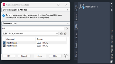

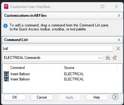

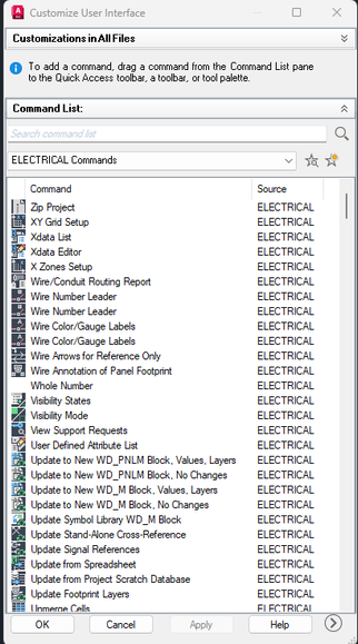

  • RMC again and select "customized commands".  The Customize User Interface will appear. In the Command List: section select Electrical Commands from the drop-down list.
You can also use the search field to locate a command Ex: Panel Item Balloon.  Type Balloon in the search and the associated command will appear in the list.
Select the command and drag it to your new tool palette.
  • Repeat these steps to populate with whatever you need to streamline your design process.
  • Once completed, RMC on the flyout and select "allow docking. RMC again and select "Anchor Left/Right to place the tool palette to whichever side of the screen you prefer.
