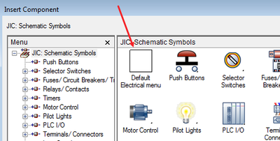

So to try this, using Notepad I opened my default menu which is ACE_JIC_MENU.DAT (located at ) and I added the special menu line as shown. My custom menu is a copy of the default one and I named it ACE_JIC_MENU_PAT.DAT. It should be placed in the same folder with the menu dat files supplied.
**M0
D0
JIC: Schematic Symbols
Special menu|special_menu.sld|$C=(c:wd_loadmenu "ACE_JIC_MENU_PAT.dat")(c:wd_insym_go2menu 0)
Push Buttons|s2(s_pb)|$S=M3
To see the change I did this while AutoCAD Electrical was not open. Then I opened AutoCAD Electrical and picked the Icon Menu command. This causes the menu file to be read. And I see this -
My button for switching to my menu is a blank box because I don't actually have a special_menu.sld. I can use a regular .png file for my image if I want. I tried this and put the png file in the same folder as the menu .dat file and it worked fine.
Then in my custom menu I added this line, right below the menu page title -
**M0
D0
Default Electrical menu|back2wd.sld|$C=(c:wd_loadmenu "ACE_JIC_menu.dat")(c:wd_insym_go2menu 0)
This way I can get back to the standard menu. Again, I don't have the back2wd.sld so it looks like a blank box.
If this doesn't work for you, please upload your menu files with a reply and I can take a look at them.
