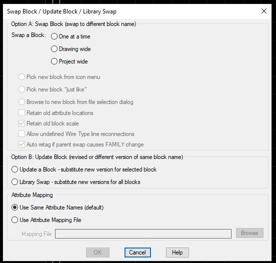

Thanks for the information, but I'm still struggling a bit.
I have added the new attributes and saved the drawing as a new template, see attached.
I'm not sure I'm using the correct "Swap/Update Block", is the attached picture the correct section I should be in?
sorry.
Regards,
Josh
testsubject
You are in the right spot.
Select Option B: Update Block.
Click on the titleblock and then select the updated titleblock.
When done, run titleblock update to refresh the titleblock with the new information.
