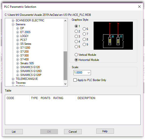

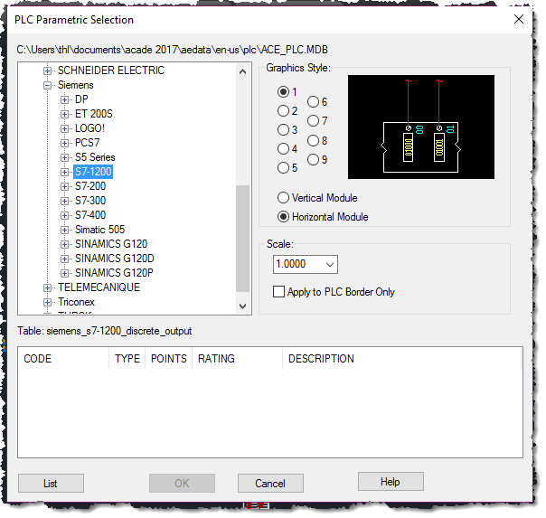

rhesusminus
While waiting for Autodesk to do something, here's how to add it yourself:

vmathot
Thanks for the demo, but it is a long process...I need several parts for ET200Sp and S7-1500. I did some blocks directly copying some old ones.
Is it a way to get a library update? Or I just need to wait the next release?

rhesusminus
Honest answer?
I'd just create them myself.

rhesusminus
No. They're not part of 2018 OR 2019:
And.. They're not part of the content pack for 2019: https://knowledge.autodesk.com/support/autocad-electrical/downloads/caas/downloads/content/autodesk-...
