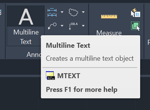

hello does anyone know how to turn off this command, he really interferes with my work when mline trim. please I really need help on how to turn it off

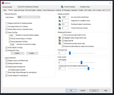

Show Tooltips on feature buttons:
Check this article - https://help.autodesk.com/view/ARCHDESK/2026/ENU/?guid=GUID-F464608C-15BC-48E8-9484-D311053D9B73
