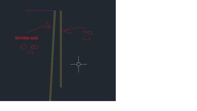

I have a wall that need to be 1.47 angle from the wall next to it. see pictures. but i get a stepping or wrinkle line/wall.  this happened with a PL, L or wall.

That's your monitor/graphics card, not AutoCAD: is this a sudden new problem?
Or did you just upgrade/get a new PC?
Or...?
What is your AutoCADARCH version as listed exactly in ABOUT command in the program please?
And your OS is...?
What are your monitor display settings? And the manufacturer recommended default settings are...?
Can you share a screenshot of your GRAPHICSCONFIG command pop-up please?

see print job,  attachment. step/wrinkle wall.
AutoCAD Archit 2022.
I really haven't used autocad in drawing capacity. i am an autocad electrical.
Navia card m620 quarto, 29" HD 4k monitors.
thanks.
Alebron
Alebron
I disable, graphics hardware acceleration, looks much much better.
