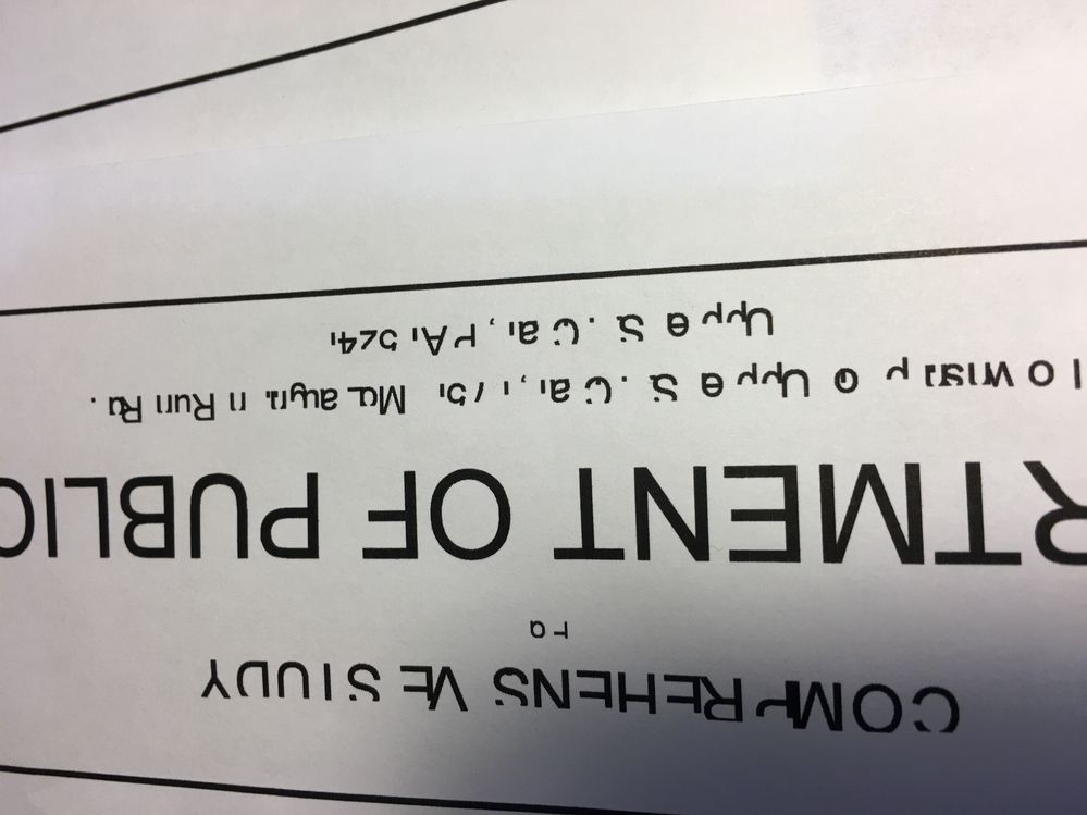

I'm still having an issue though. Entire drawing plots fine except my address in the title block. The top of the letters are cut off. Whats strange is that the project title is in between the lines of text that cut off however it prints fine. Our plotter is haunted or something. I printed 3 full size test plots and each one has the text cut off exactly the same way and in the same location with things in between all fine. I'm printing it from a PDF and the PDF text looks fine even when I zoom in super close.
As you can see in the pic. "department of public" prints fine but below and above it cuts the text off. It also print the edge of the title block on that side fine.
 It's also bizarre because it doesn't cut it off in a straight line. Most letters are cut off in what seems to be a straight line but others aren't cut off much at all. A few letter are cut off more and only show like a dot at the bottom.

dbroad
I wouldn't recommend plotting extents or display.  Use a window selection and decide what you want to plot.  Then either decide what your binding margin should be and set that to the origin or use the center plot checked.  My standard for years has been to design my titleblock to have points on each of the four corners (on layer defpoints) that exactly match the sheet size (24"x36") that I intend to plot on.  Then selecting that window takes care of the binding margin for me when I center the plot.
Another alternative is to set up your layout exactly as you want it to plot with no extraneous lines outside of the paper area and to use that option with center checked.  I always use 1:1 scale in layouts.  I typically never set up custom sizes for standard size sheets.
I have no idea what is causing your letter tops being cut off.  New font problems perhaps?
