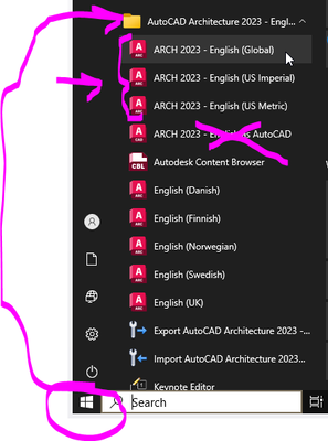

For some reason when AutoCAD Architecture 2023 was installed into my computer, none of the AEC Content loaded and my AutoCAD looks and only has features of regular AutoCAD. None of the features to add walls, doors, etc appear on the tool bar and even in the options panels the AEC Content does not appear. I have tried about everything to try to link the program files to CAD Arch but nothing seems to work.

You appear to be running "as AutoCAD", start by changing the profile in one more more of these spots
