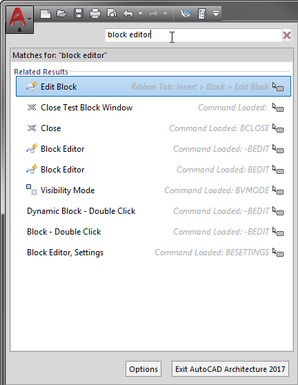

One item that I find useful when trying to find something in the interface that I rarely use, so forget its location, is the search feature on the Application Menu.  Typing in block editor calls up a number of items; the first one in this case is the Edit Block ribbon tool.  The location of the tool is shown, and you can click on that result to initiate the command.2018-07-06_ACA2017_ApplicationMenu_CommandSearch.png
