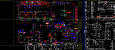

Recently, I opened a file from another company that was a different unit: centimeters.  I changed the file unit setting to meters, redrew the equipment, changed back to Feet/inches, then moved to my drawing.  I wonder if that messed up my settings so they don't display correctly.
Here is a screen shot of the file.  Notice, the yellow aisle lines are correct. But the grey lines attached to the red equipment are solid. They are supposed to be dashed lines.
MSLTSCALE is 0
PSLTSCALE is 0
LTSCALE is 24  (we plot 1/4" scale)

Were those linetypes already in your file, or did they come from the other file (that started out metric)?  If they are metric linetypes, based a unit definition other than inches, then they may not work with an LTSCALE value of 24.
If the DASHED linetype is one of the affected linetypes, try reloading it from ACAD.lin.  If you have imperial versions of the other linetypes, reload those as well.

They were existing lines that were functioning correctly last week.  They were made in imperial version file.  They suddenly changed.
Every file is displaying incorrectly now yet they plot correctly.  There is something wrong with the program. Do I need to uninstall it and reinstall?

It needed an update.
But Emerson is now making everyone get an admin before installing or updating. Once I got an admin then the computer to make an update for the program. Then, once CAD was updated, it displayed lines correctly.
