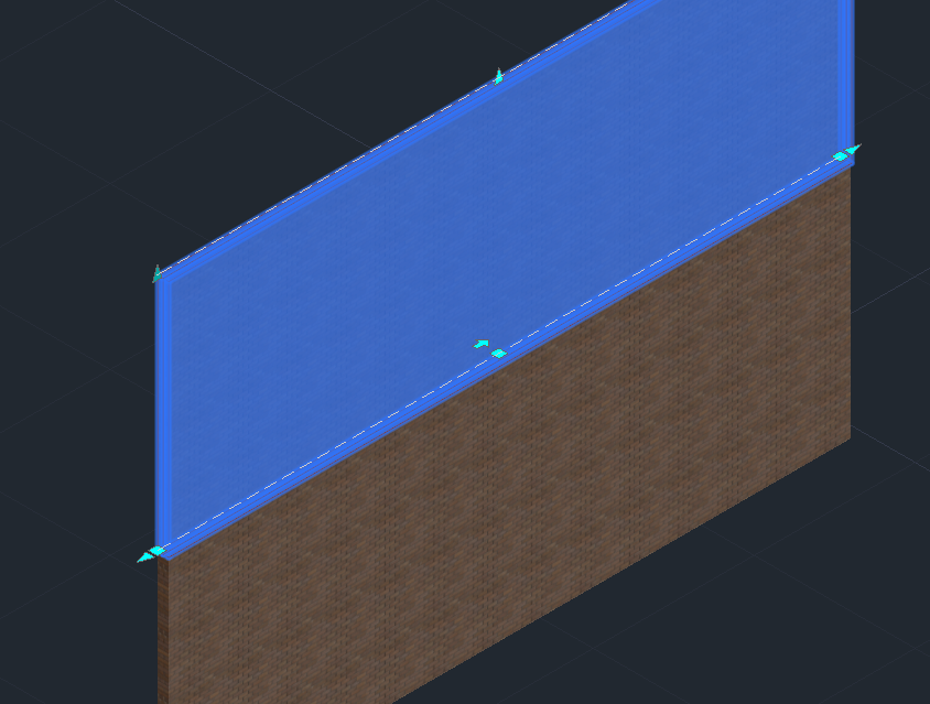

I'm not sure what you mean. If I have two walls with one above one another with materials assigned to them then they don't appear to have a line separating them with the realistic visual style that shows the materials. Here is my drawing with two walls:
Here it is without one being selected. No lines between the two:
If you are not seeing the same, can you post a sample drawing and screen capture of what you are seeing on your computer?
