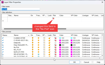

Sorry to revive an old thread. But the marked solution didn't solve the problem of the filters with "No Plot" being saved.
We need a layer filter to show all "No Plot" layers. The filter is created changing the "Plot" column to "no plot" and works great.
But when the filter group is saved and loaded into another drawing the filter is still there but the settings to the "Plot" column have been removed.
Anyone know of a way to fix this?
