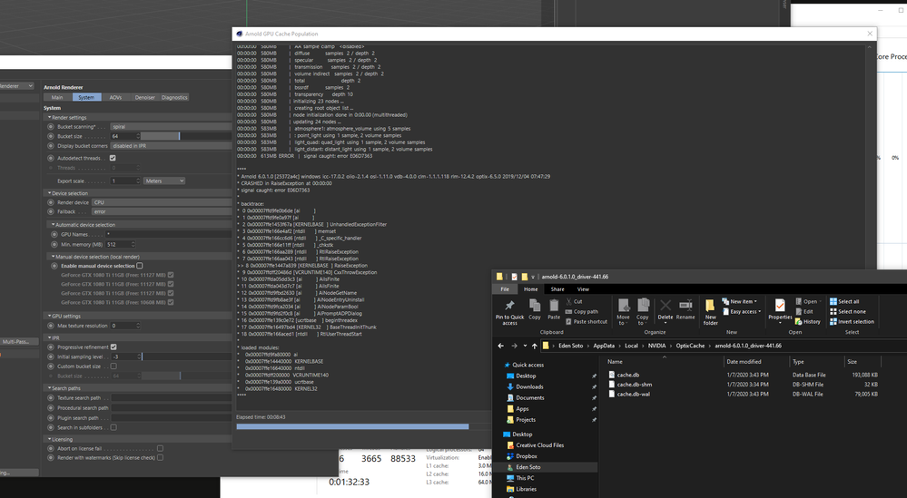

4x 1080 Ti's... C4D R21 up-to-date, latest NVIDIA Studio Driver, latest C4DtoA plugin, here's the log...
gpu_cache_population_log.txt
I've deleted the cache in AppData\Local\NVIDIA\OptixCache\arnold-6.0.1.0_driver-441.66, but each time I try to run it with all four GPUs in the system, it fails (see screenshot below for final crash entry)... I delete the cache before each new attempt.
If I run it with just one GPU in the machine, it completes successfully... with all four in, it's a guaranteed crash.
For what it's worth, I can render with all 4 GPUs no problem with Redshift, so the GPUs themselves are fine.
Would love to know if anyone knows why this could be happening and/or how to get around it

I'm going to restate the problem to make sure I have it right. Because the screenshot shows a crash during rendering.
But really the problem happens before the render, when the pre-population fails with this error:
[ERROR]     internal error during render permutation 11/40:
So, GPU Pre-Population failed, and then when you tried to render using that GPU cache, the render failed.
Can you delete everything in AppData\Local\NVIDIA\OptixCache, not just that one folder?
Then try to pre-populate again

Thanks Eden and Dante for your detailed investigations! It looks like NVIDIA has been able to reproduce a driver bug where using 4 or more GPUs with textures will usually cause a crash. This bug could in theory also cause crashes when not using textures or using less than 4 GPUs, though we haven't yet been able to confirm how common this is. They're making good progress towards fixing it, so fingers crossed, it will hopefully get fixed in one of the upcoming driver releases.
In the meantime, you can render with 3 GPUs in order to drastically reduce the likelihood of a crash and we'll also investigate whether there are any workarounds we can do in Arnold.
