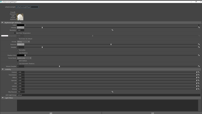

why the back of the specular reflection is all black when arnold renders the normal? Even if exit to background is enabled.

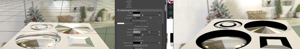

  1. when I used the normal map.
    It seems that it can't calculate the ray depth for the parallax effect generated by the normal map.
    Other renderers may
    So I tried to find a way to get arnold the right result, but I couldn't.
  1. The test scenario is just a plane plus the first picture in Google search normal map.
    And aistandardsurface with a metal degree of 1 and a roughness of 0 is used.

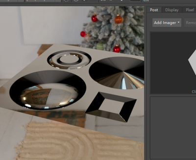

this is new arnold render,but the result is still not correct.
And this is to open mikk, and the result has not changed.

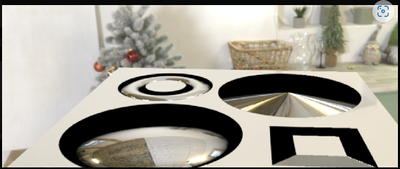

It's not just me. This is a youtube video tutorial by a great artist.
arnold seems to render normally only in a small range of normal or bump, and once it exceeds a certain angle, it will be displayed in black. This is completely different from other renderers.
So this is the correct result, or the result of other renderers.
And these two are arnold's results, and they are both wrong results.

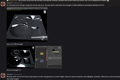

I don't know whether other renderers use some approximate algorithm to simulate, maybe it is not necessarily accurate, but at least the results rendered by other renderers or mayaviewport2.0 are very good and correct in my opinion. If you add a normal with a hemisphere to a plane and add a real ball to the scene, you can see the results of mayaviewport2.0 at the same angle, and the reflection results of the real ball and the plane (with normal map) are exactly the same. If everything should be presented in real geometry, the meaning of normals will disappear. The meaning of normals is to present high-mode details for fewer polygonal meshes and deceive vision. However, the normal angle supported by arnold is too small, and a slightly stronger discovery map will cause problems. That is to say, basically downloading a set of pbr maps from online materials can't be restored correctly. For example, downloading the normal of a brick wall casually can have beautiful effects in other renderers, while arnold will have inexplicable shadows.

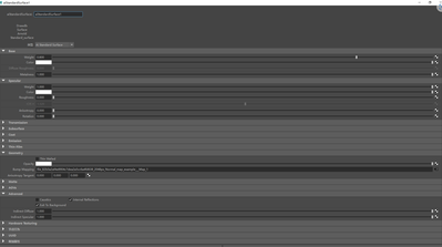

所以事实上其实arnold的结果并没有问题,光线追踪渲染器理论上确实会得到这样的结果。
所以事实上是我错了,虽然从理论上来说mayaviewport的结果似乎看起来不错,但是确实是有问题的即使这个结果作为人类来说看起来似乎很合理也好看不少。
原因是一些视角下法线贴图改变的法线会导致视角变成在假想法线的平面背面,导致了黑色的镜面反射。maya的viewport预览的法线效果虽然不会有黑色,但其实也并不算正确,它只是把越过法线假想平面的视角继续计算然后找到对应的hdri角度的像素显示出来而已。
