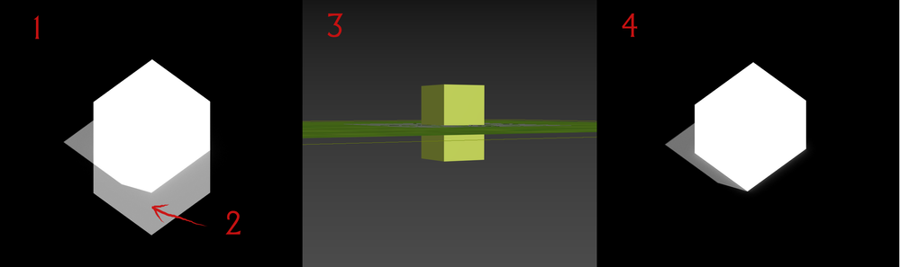

We've run into some issues with using this approach. Some of our objects extend below the ground plane. Since it's being set using transparency the part of the object below the ground should not be viewable but is showing up. I've attached an image. 1 is the render with the object extending below ground. 2 is the bottom part of the object below ground that shouldn't be showing up. 3 is a viewport view inside of Max with a low angle. 4 is how the alpha should look. Is there something I'm doing incorrectly or is there another solution? alphaproblem.png

https://docs.arnoldrenderer.com/display/A5AF3DSUG/Clip+Geo
Use the clip geo closure, it will automatically cap off anything inside it.
Here the box is cut dispite it is nested into the ground and the alpha shows a clean result. Note you need to add an Arnold properties modifier on the clip box and disable shadows so they dont translate to your alpha.

Yup, that did the trick! Thanks so much.
