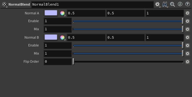

Houdini
5421-htoa-nmb.jpgmtd & aeTemplate here:
NormalBlend.zip

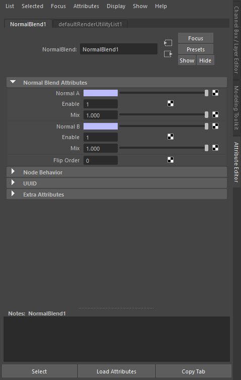

ah so you need some complimentary ui files for those 2 hosts.
Thanks for the files.
Ill try ship shaders I am rolling out on my site with these files as well so maya/houdini folks will get these along the downloaded shader.
I may be back to ask for testing or ask for some coop QA for UI :leicht_lächelndes_Gesicht:

Great.
I stole your images and will make a 4th for MAX, then submit a post in my OSL Shaders category on my site with some explainations and so on, full credit for the UI file work OFC.
Ill attempt to make a template that other shaders can follow.
