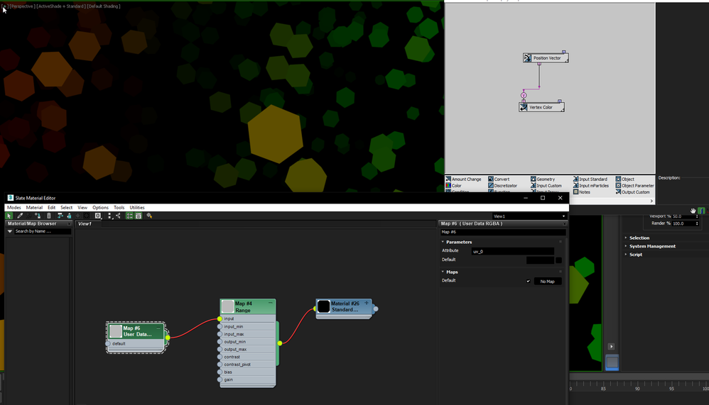

And here is the pr. particle location ID in world space ported from the particle generator, to uv_0 channel which is caught by a shader chain and printed to the closure output -> back to particles to give them a solid color based on location, color is vector, so we can now process the vector data in OSL like normal 3 component vector handling.
I use Arnold data node, but the same apples for the OSL code used.
