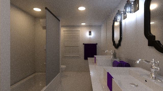

Hello Arnold Answers.
I was doing a quick scene render test and for the first time I added mirrors, I noticed the light sources are only glowing there and not in the main scene itself.
For this scene, I'm only using two lights: one Arnold disc light and one mesh light. I've also have an emissive material applied with the indirect diffuse set to 0.
I once turned off the emission material and toggled "light shape visible" but the bloom still only shows up in the mirror.
Regarding the mirror material, I'm actually using the physically correct version by placing a glass object in front of a really shiny metal base.
Edit: Here is the the actual scene information. Again, I did turn off the emission material and turned on "light shape visible" but the bloom only shows up in the mirror.

If you want the lamps to glow, you kinda need to add a post bloom/glare effect.
There is a free framebuffer for 3ds max you can download and give a try.
http://www.monotoneminimal.com/vfb

The mirror creates bloom due to the rays travel through some medium, you can sharpen them up so the reflections does not bloom, this will return a situation where you can bloom everything.
You cannot get any bloom on the direct rays when you have no medium infront of the rays so they scatter, you either do it in post, or add a coat on the lens with blury refractions to create it, which is not very sexy.

I would use a disk light and add a small amount of Atmosphere Volume. You could use Affect Reflection to control how much you want to see in the mirror.

@Lee Griggs method worked. I added the atmospheric volume and turned down density to the lowest single digit (otherwise, the entire scene was just white) but otherwise, the bloom looks much more natural now compared to postprocess methods.
I'll maybe tweak some other settings so the god rays aren't so long. Maybe the Attenuation or the Eccentricity parameter does this?

Here's one more update. I now have settings that will work under any interior lighting so it doesn't have to resemble foggy weather or look cartoonish.
I'll explain what I did:
Density: The lowest value in the material only allowed for 0.01. While not too unacceptable, I wanted an even lower value so I could use this in any interior scene without problems. So I plugged in a vector/texture map and was able to use an even lower value (0.001).
Attenuation: I played around with this however, I decided to leave it at the default of 0. What I found was increasing this number stopped the light rays half way, leaving the floor and surrounding areas too dark or without any illumination.
Eccentricity: I increased this to 0.9. My rationale, I wanted to exaggerate the bloom effect and create a nice glow around my lights. By leaving it at 0, it resembled "god rays" or the bloom effect traveled down when I want it to go up and disperse in a circle like real lens flare.
Samples: Left it at 5. When doing a final production render, everything gets more crisp anyway.
Of course, these are just my settings I used and some of them have a stylistic purpose given them.
Also, ignore the noise. It's not coming from the bloom/fog volume, I just have a really old CPU.

Nice, you can also reduce the effect on a per-light basis using volume contribution.

Thanks. I just used that technique to control the bloom on one of my lights without having to affect all of them.
I've also made a few more updates.
Samples: In an earlier post, I said to use 5 in the atmospheric fog volume. However, after closer inspection I raised it to 10. This was to help clean up some harsh artifacting and noise.
EXR format over JPEG: This one should be obvious but an EXR format is absolutely critical for bloom, since there is a wider bit depth. Going with JPEG limits this potential since there is more banding and compression instead of a nice soft gradient. The image I posted above, the left is a JPEG source and the right (final render) came from an EXR.
I've also said this was originally meant for an interior scene, but since there are now so many ways to control the strength of bloom in the Arnold settings, I think the atmospheric volume could be used in any scenario.
For example, I was just outside and having lens flare would be important for all the car and street lights you see at night.
