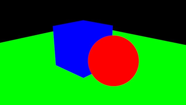

You can use the Arnold Custom AOVs tag with only 3 materials to assign different rgb ids. i.e:
Beauty:
ID group 01:
ID group 02:
rgb-ids-aov.zip
