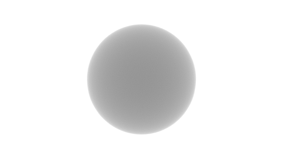

here we're talking about microfacet reflections, right ? so you have to set metalness to 1 with also base=1 and specular=1 .. ie full reflections with no fresnel (or another setup.. diffuse to fully black and ior to 500). attach a default skydome light (with full white color) to your scene then start increasing roughness on your material ... you'll begin to see energy leaking from 0.2 and up.
# copy&paste it into energyleak.ass then ..
# $ kick energyleak.ass
options
 AA_samples 4
 outputs "RGBA RGBA filterg driverx"
 camera "perspShape"
 xres 960
 yres 540
 frame 1
gaussian_filter
 name filterg
driver_exr
 name driverx
 filename "microfacet_energyleak.exr"
persp_camera
 name perspShape
 position 0 0 10
 fov 40
skydome_light
 name aiSkyDomeLightShape1
 color 1 1 1
sphere
 name mysphere1
 radius 2
 shader aiStandardSurface1
standard_surface
 name aiStandardSurface1
 base 1
 specular_roughness 1
 metalness 1
output :
Nachricht 8 von 9

I made a mistake and didn't set metalness to 1. Now I get same results as you.
Thank you very much for the explanations.
It's good to know that aiStandardSurface is not 100% energy conserving on high roughness values.
