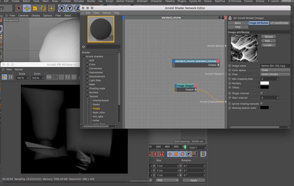

Hi Lee...got an idea on some of the problems I've been having....now for the latest....there are several (many) cloud vdb's I got from the internet which I can not see their bounding box in the viewing window...is there an easy way to get an idea of their size or to size them so they fit a window? Problem 2, following your Polymesh to Volume, I am lost when it comes to adding the image to the displacement texture...can you take a look at the attached pictures and let me know if I am doing this all wrong? Thank you so much for trying to get me through this

That is displacement for poly meshes. You need to connect the image to volume_displacement.496-volume-displacement.jpg
