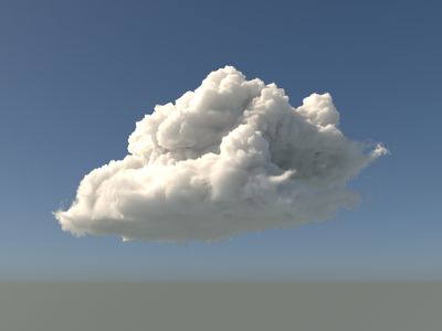

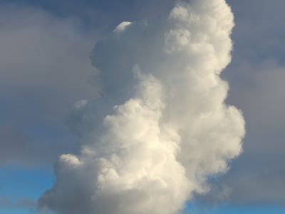

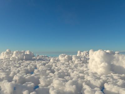

  • Support for mip-mapped OpenVDB files on CPU: The volume node now accepts OpenVDB files with mip-mapped grids. You can generate volume mip maps with the Arnold API or with kick (see API Changes below). The different mip-map levels are distinguished by _level_N suffixes, where N is the mip-map level. Arnold then automatically chooses the appropriate mip-map level during rendering, which gives substantial speedups in volumes with a lot of scattering (for example, clouds) in exchange for mostly small differences in look. Volumes with more mip-map levels can have larger differences in look. Users can also specify mipmap_bias on a volume node or on its instance (by declaring user data of the same name), which adjusts the automatic mipmap selection by that amount. (ARNOLD-14453, ARNOLD-15056)
    CPU volume mip-mapping speedups
      wdascloud byc-cloud composition 1 composition 2 sunset clouds
    Speedup 1.5x 1.9x 2.6x 2.1x 1.8x
    Speedup 2.0x 2.8x 5.2x 3.2x 2.7x

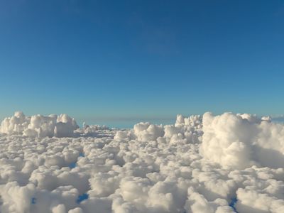

  • Improved GPU volume rendering performance: GPU rendering of volumes is up to 3.5x faster. (ARNOLD-8936)
    GPU rendering speedups
    Speedup 2x 1.12x 3.7x 3.5x 1.31x
