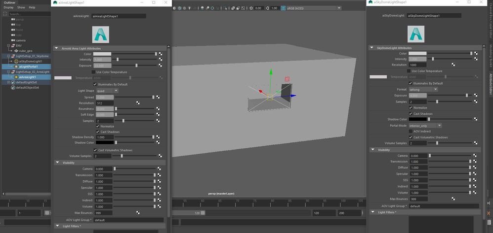

Hey all, just posting a render test I did regarding AreaLight portals vs Skydome + Portal.
I see LightPortals are mentioned quite a bit on and I wanted to accurately test the efficiency compared to arealights. (I've used both setups on multiple productions)
The test scenario is a cube with a hole for a window.
Pretty default lights. Arealight and Lightportal in exactly the same place. There is a slight visual difference which to match the "look" would require moving the arealight back and adding a near light decay—which for testing purposes I didn't want to do.
