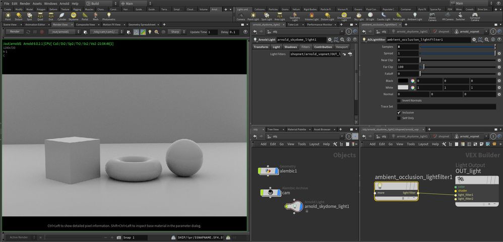

yes you are right
here is the screenshot for Maya
for Houdini
For cinema4D
and here is the zipped file (maya asci file, houdini file, and Cinema4D file )
aoLightFilter.zip
