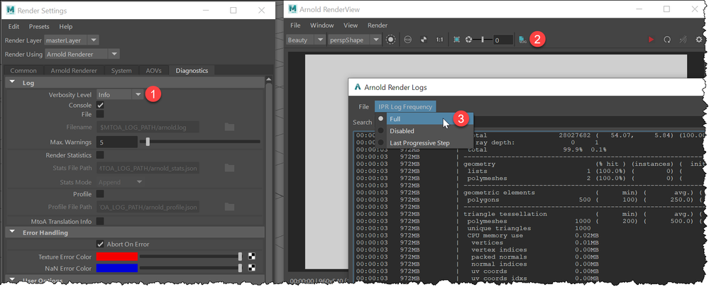

Hi all,
I have MtoA-4.2.4-2022 installed in Maya 2022. Unfortunately despite enabling GPU in Arnold's settings I am getting slow renders and lots of instability. There are many fatal GPU errors occuring.
Error: [gpu] Fatal GPU error occurred, please restart the host application //
Here are my Arnold settings.
Here is a random error:
My last log is attached.
Any help at all would be incredibly appreciated.
1,674 Views
Stephen.Blair
Can you post the Arnold log? That's the one we need to see.
Instructions for generating full verbosity log files are available for MtoA, MaxtoA, C4DtoA, HtoA, KtoA, and Kick.
After there is one GPU fatal error, you have to exit Maya and start it again.

I will get back to you with a log very shortly. I've stopped using GPU all together because of how unstable it is. Especially with volumes.
futuremotionrecovery
00:00:00  1902MB WARNING | /aiVolume/aiVolumeShape: could not set BOOL parameter "disable_ray_extents"
ERROR   |  [gpu] an error happened during rendering. OptiX error is: Unknown error (Details: Function "_rtContextLaunch2D" caught exception: Encountered a CUDA error: cudaDriver().CuEventSynchronize( m_event ) returned (700): Illegal address, file: <internal>, line: 0)
    GPU 0 had 8972MB free before rendering started and 6629MB free when crash occurred
I just created a simple scene with a base mesh and a dome light and that rendered fine on the GPU. It's something about my other scene that's crashing the GPU render. I'll have to narrow it down somehow.
