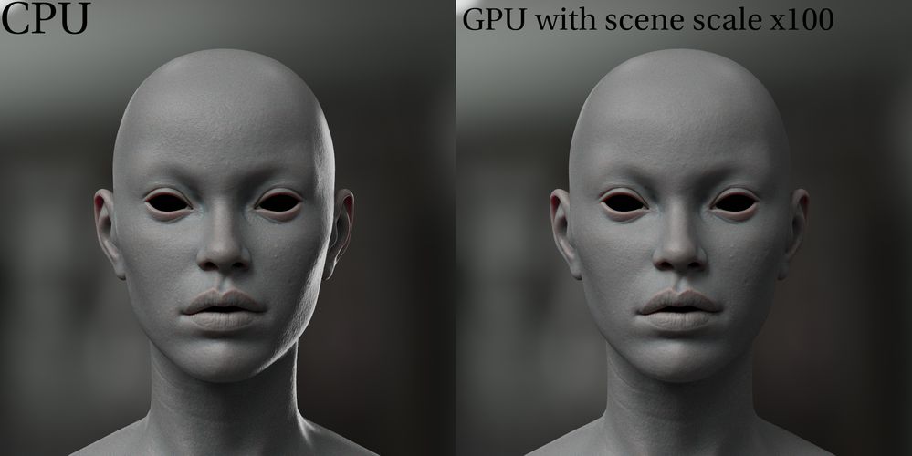

Hello everyone, I'm having shocking difference in how SSS is rendered in GPU versus CPU.
It's done in the IPR of Solaris, and I can't figure out if it's a software limitation or some settings are off.
Not only the redness of the SSS radius not coming out but also the scale seems off.
Does someone had the same issues ?

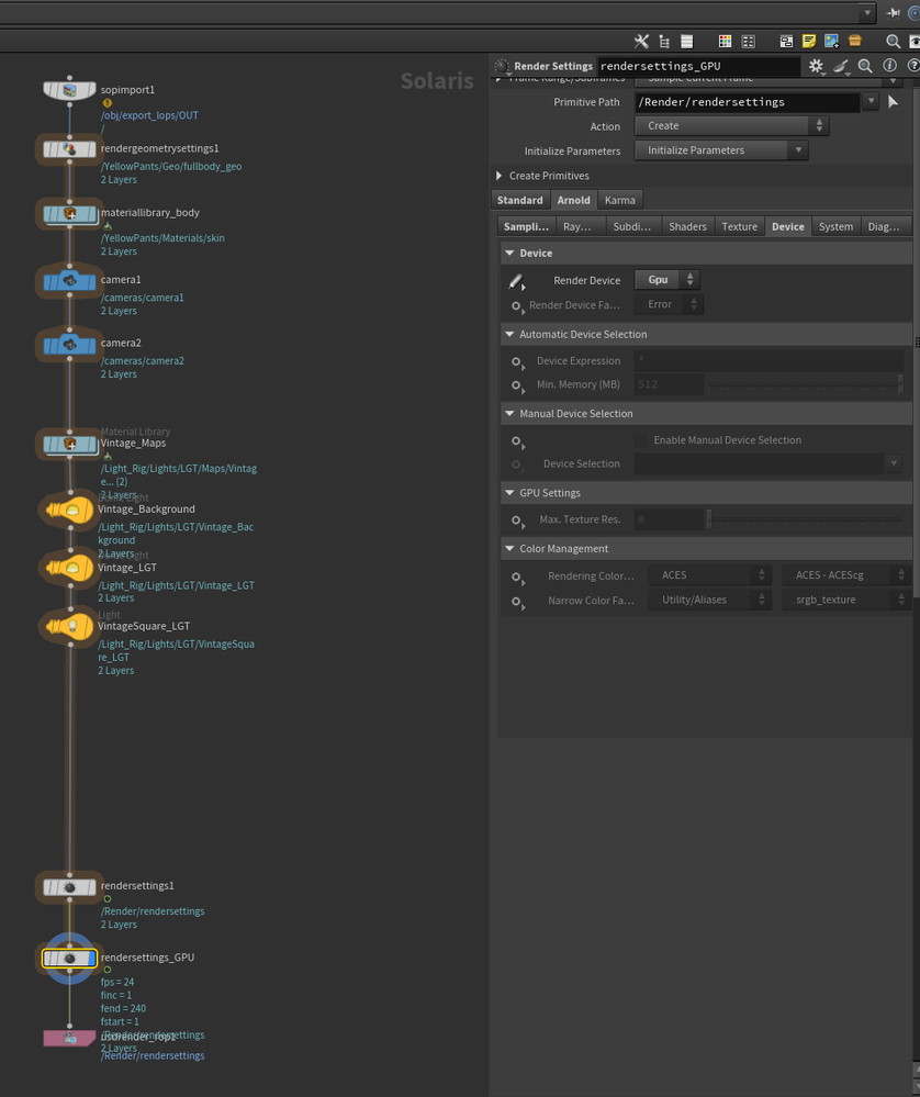

Render Settings are similar, I only boost the Max Samples for Adaptive Sampling from 10(CPU) to 24 for GPU, it's a simple grey shader with RandomWalk v2 SSS with a displacement.
HtoA 6.4.2.2 | Arnold 7.4.2.0

robert.pashayan
You do a CPU render of an object with SSS, then add another render settings node in the end, where you activate the GPU render in Arnold and add AA Samples(optional). That's all.
See bellow, the rest is exactly the same.

"repro" is short for "Reproducer". You need to upload a scene that reproduces the problem so that we are testing exactly the same thing. I suspect that what you're seeing could be due to certain SSS settings and if we don't use your settings or you mesh we won't have the problem you cite.
In any case, I suspect your problem is the same as https://forums.autodesk.com/t5/arnold-for-cinema-4d-forum/sss-issue-in-gpu-mode-randomwalk-v2/m-p/13... which is due to numerical precision error. Scaling everything to be larger is the current workaround until this is fixed in Arnold.
robert.pashayan
Hi Thiago, spot on, thank you.
By multiplying the scene scale by 100 and adjusting the SSS value I got a very similar result.
