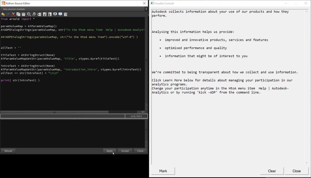

Stephen.Blair
Run this python in Houdini, do you get the same error?
from arnold import *
paramValueMap = AiParamValueMap()
#AiADPDialogStrings(paramValueMap, str("in the HtoA menu item  Help | Autodesk-Analytics").encode("utf-8"))
AiADPDialogStrings(paramValueMap, str("in the HtoA menu item").encode("utf-8") )
allText = ''
titleText = AtStringStruct(None)
AiParamValueMapGetStr(paramValueMap, 'title', ctypes.byref(titleText))
introText = AtStringStruct(None)
AiParamValueMapGetStr(paramValueMap, 'introduction_intro', ctypes.byref(introText))
allText += str(introText) + "\n\n"
print( str(introText) )
// Stephen Blair
// Arnold Renderer Support
Message 5 of 8
