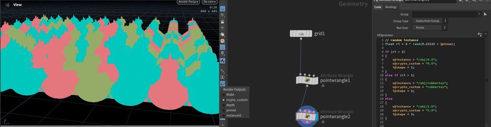

You can control the color of crypto_custom by changing the string letter "a" to a "float" or "integer"
some example showing different string name:
