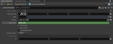

supervisorAlone
Hi solved dragging camera from Scene graph path (not with operator chooser) and put correct aspect Ratio
