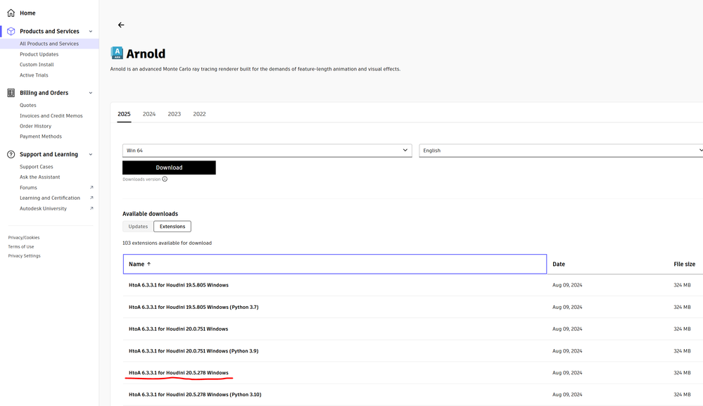

How can I find the version made for Houdini 20.5.278?
What should I do to solve the problem?
tom_minor-arnold
You can find it the Arnold download portal - go to the Arnold >> 2025 >> Extensions tab and search for "HtoA 6.3.3.1 for Houdini 20.5.278 Windows"
