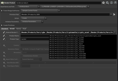

I'm trying to get Cryptomatte working with a "custom render setup" as the Arnold Render Settings HDA isn't working for our purposes. (can't adjust Contour Filter Width)
I've added the "arnold_cryptomatte_aovs" HDA instead, and added them to the Render Product.
However, this isn't working for me in Nuke.
(it doesn't help that the old "Preview in EXR" feature was removed and I can't check if it's working in Houdini)
The cryptomattes are added using the arnold HDA
They are then added to the "Render Product"
The Cryptomatte shader that comes with the arnold HDA is added to the Render Settings.
The AOV appear in the render.
The Cryptomatte AOV aren't working in Nuke. The layer selection is empty and doesn't show any AOV.
Please can you advise to get Cryptomatte working with the manual/custom setup?

You have to use the arnold product type.

am_wilkins
Hi Stephen,
When we do this, then all the AOV break/disappear.
Product Type set to Arnold
Doesn't work locally within Houdini nor rendered through a USD Render ROP.

Stephen.Blair
Cryptomatte works. I do it all the time, and I've set up many customers.
  • You must use the arnold product type.
  • If you use Override Output Image, that output does not have cryptomatte. That's a known issue. You have to use the Render Product name.

am_wilkins
Thank you Stephen,
I'm using the "arnold" product type, however I was overriding the "USD Render ROP" image path.
I've set that on the Render Product now rather.
PS. the AOV still break within Houdini straight away after changing to the "arnold" product type.
Not sure if that's a known issue?
However, although we are now seeing option in the "Layer Selection" the Cryptomatte AOV within Nuke still don't work.
Viewing from the "Cryptomatte" node, AOV are present and showing in the Layer Selection.
I tried to put a standard surface on the default sphere but that didn't help.
Just to show, the RGBA does have information - the render isn't black. It's just when viewing the cryptomatte, it doesn't work.

peterDTE7K
Hey Andrew, it works also when you switch to husk.

peterDTE7K
Hi Andrew, you need to remove this node.
-Peter
Message 13 of 15
am_wilkins
WOW, are you kidding me 😅
Yeah that was left over from all this testing, completely unconnected to anything but I guess perhaps clashing with the one the Arnold HDA makes. Interesting that breaks Husk but not Sick.
