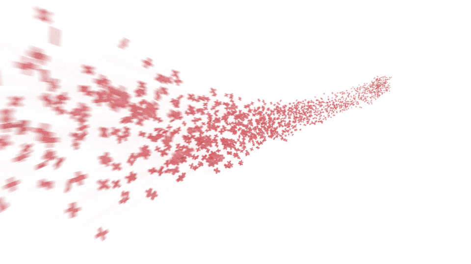

I want to add motion blur to shapes being emitted. No matter what I do to the settings, I get way too much motion blur. I've tried adjusting almost every setting I can possibly find (I have a very basic grasp on the sliders I must admit). But the funny thing is, no matter what I change in the settings, I get the same amount of motion blur.
At first I realised I was working to a very small scale, I thought that must have been the reason to my absurd amount of motion blur, but even after calling it I still had the same amount of motion blur... I'm pulling my hair out.
I've tried changing the shutter speed/angle in the camera
the length and position in my render settings
enable/disable camera checkbox in my render settings
enable/disable deformation checkbox in my render setting
adding/removing Arnold tag to camera in my render settings
scaling the scene up/down
Every single render - actual render, not IPR - is almost identical. With way too much motion blur...
I'm using C4D R20
Please help!!screenshot-2021-11-25-at-135453.pngscreenshot-2021-11-25-at-135413.png

Both, the length in the render settings and the camera shutter size in the Arnold tag should affect the motion blur effect. What type of simulation is this (C4D Emitter, X-Particles)? Can you share the scene?

Here's a render from the test scene I just sent to you:
peter.horvath6V6K3
When rendering motion blur, the plugin basically moves the timeline and exports the position of the particles in each keyframe. How many keyframes do we have depends on the Keys parameter, the Length defines the size of the window, the Position defines where the window starts. So a center motion blur of length 0.5 with two keys per frame looks like this:
Now the tricky part is to identify particles between frames. Particles have no ids in standard Emitter, so all we got is the particle order. If that changes between frames, which does in you setup with the Matrix object and Cloner, will mess up motion blur. It's a limitation I'm afraid.
You can try to increase the number of Keys to something like 5 or 9, change the position to 'start to frame' maybe, so that there are more samples and the particles don't mixed up. For instance I've got this with 9 keys:

How on earth you figured that out is beyond me. But thank you! Your render is 90% to where I'd need it, so I'm sure with some tweaking, I can get it to where I want with those base settings. Also, it's good to know that's a limitation; I thought I was going crazy...
Thank you so much
chris.holland7P2HP
If I add a rigid body tag to the cloner and cache, the motion blur works as it should with the usual settings working fine. Just in case someone else stumbles across this post.
