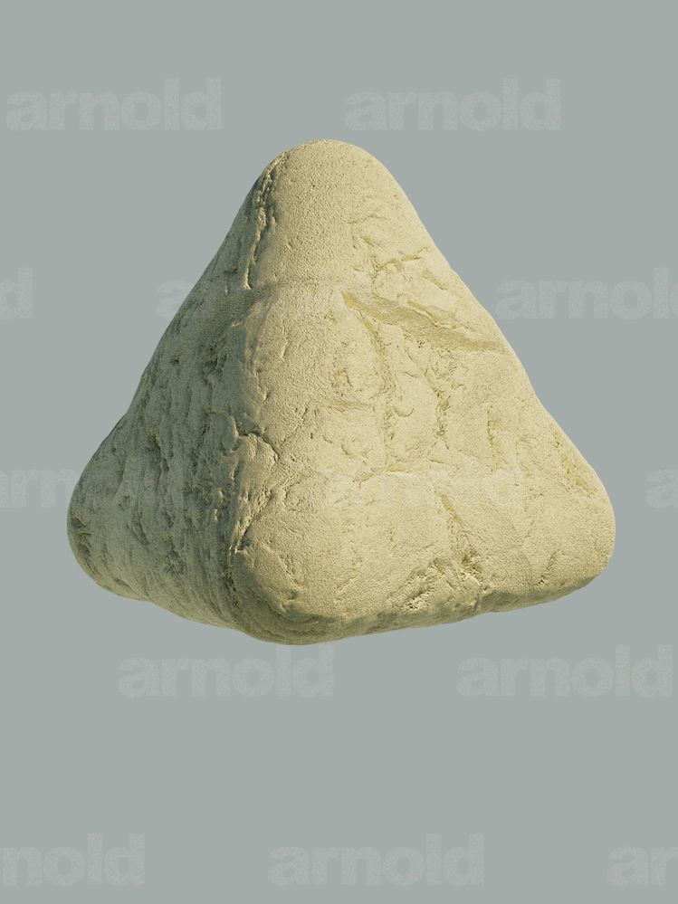

Hi there - the Scene File to reproduce this behavior
I tested it in CD4toA 3.0.3 / CD4toA 3.0.3.1 / CD4toA 3.0.4
The scene has three cameras. The activated autobump state triggers a correlation between the distance to the object and the percentage of the CPU utilisatzion. Changing the displacement height also alters that behavior.
R21 CD4toA 3.0.2.1 Cam B - 11 sec
R21 CD4toA 3.0.4 Cam B - 39 sec
R21 CD4toA 3.0.2.1 Cam C - 30 sec
R21 CD4toA 3.0.4 Cam C - 8min 39 sec

OK, I think I know what is going on. There are actually two unrelated problems.
1. The texture cache being 10MB will for sure kill performance. We can see that in this log file you supplied, where it took 8m43s and of that 8m10s was accessing textures:
00:08:43  1477MB         | top session self-times by category
00:08:43  1480MB         |  AiTextureHandleAccess                                              8:10.82 (93.85%)
<snip>
00:08:43  1480MB         |   Options:  max_memory_MB=10.0 <snip>
When the texture lookups were under 10MB, performance was fine, but once it went over we can get this huge performance hit. In a future release of Arnold we'd like to fix this by preventing users from setting the cache to be this low.
2. c4dtoa 3.0.4 has a change with regards to color management that resulted in the opacity being sent to arnold going from <1 1 1>, so completely opaque, to now being <1.00000072 1.00000143 0.999999821>, which in the blue channel is now just barely not opaque. This should have been the same, but computers can't do math perfectly and so this bit of numerical precision error was introduced. We'll try to make Arnold more tolerant to this type of precision error as well so that you hopefully won't get this slowdown.
So to summarize, the precision error made arnold do more work and shade more geometry. This gave a moderate slowdown. The shading of more geometry meant more texture reads which caused the 10MB cache to be exceeded and that gave the huge slowdown.
