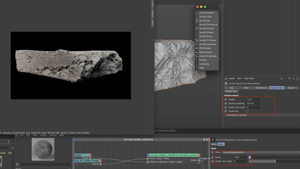

hey guys as seen on the picture below I'm trying to achieve a realistic and more sharp look on this rock I to from quixel I'm not sure what setting I should be playing with to achieve that Sharp rock edge look screen-shot-2022-03-14-at-13658-pm.jpg

It looks pretty sharp to me. You could try increasing the subdivision_iterations on the rock to 1.
Btw, I always prefer to use the high poly meshes:
