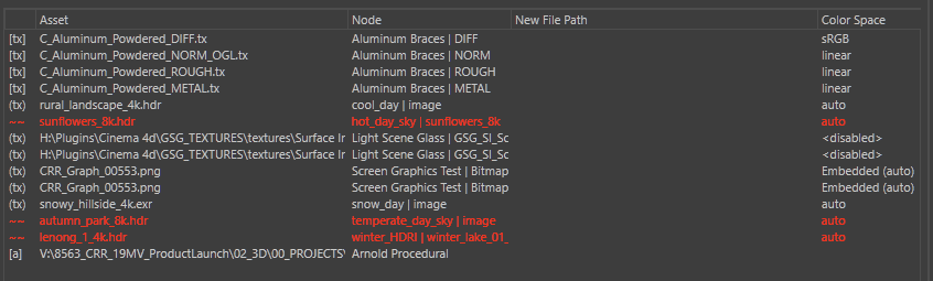

Here is what the TX manager looks like:
All of those red files are located in the "tex" folder, so Arnold should be able to find them since they are relative. Right?

Also, I was sitting in front of my computer talking to a coworker (not touching anything), and the TX Manager changed to this:
The IPR was not running or anything.

If it was just textures, then I would ask about your tx settings (because maybe one machine is updating a tx file while a second machine is trying to use the texture). But since the problem happens also with procedurals, I think it's something more general.
The Asset/Tx Manager will update if you do something that loads an image node into the attribute editor (because the material preview is updated). So if there's any kind of file/path/network access problem, the tx entry turns red
