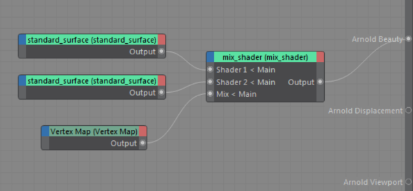

Hello, I'm having a similar dilemma trying to mix two fluids using x-particles. I've been able to use the xparticles vertex map to control the Cutout opacity of the shader but it just shows up invisible (both with the Opaque tag enabled/disabled). Any help is appreciated. Screengrab of my settings attached.
For material stacking (I believe that's what you're after here) set the vertex map on the Alpha (stacking) tab of the Arnold Material instead of the Cutout opacity. Alternatively you can create one Arnold Material with the two standard_surface shaders connected to a mix_shader driven by the vertex map, like this:
nickjonkman
in reply to: seansCWRT6
Thank you Peter - the mix shader worked great
