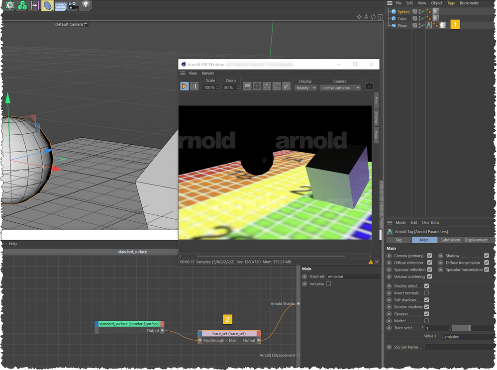

Hi ,there are one sphere and one cube in my scene, I create one plane with emission material as reflector to light cube, but how can I Exclude the sphere from this plane(Reflector)

You can use trace sets.
  1. Put the plane in a trace set (for example, "emission")
  2. Put a traceset shader on the sphere

if there are a lots objects in my scence for example object A1 to A99 , but i hope reflector(Trace_set:"Eimisson") only affect object A1 , so i have to set trace_set shader(exclude "Eimission") on per object from A2-A99 ?

If you have to use an emissive material, then I think yes, you have to exclude the trace set per object (A2-A99).
If you can use a mesh light instead, then you can setup light linking on the Project tab where you can Include only the given object (A1).
