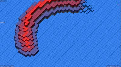

I need to make the clones change color after interacting with the Plain Effector. In standard rendering, Octane and Redshift, this can be done using the MoGraph node "Color Shader", or simply by changing the color in the Cloner tab -Transform and Color Remap (but this is not displayed in Arnold) 1.jpg2.jpg3.1.jpg
