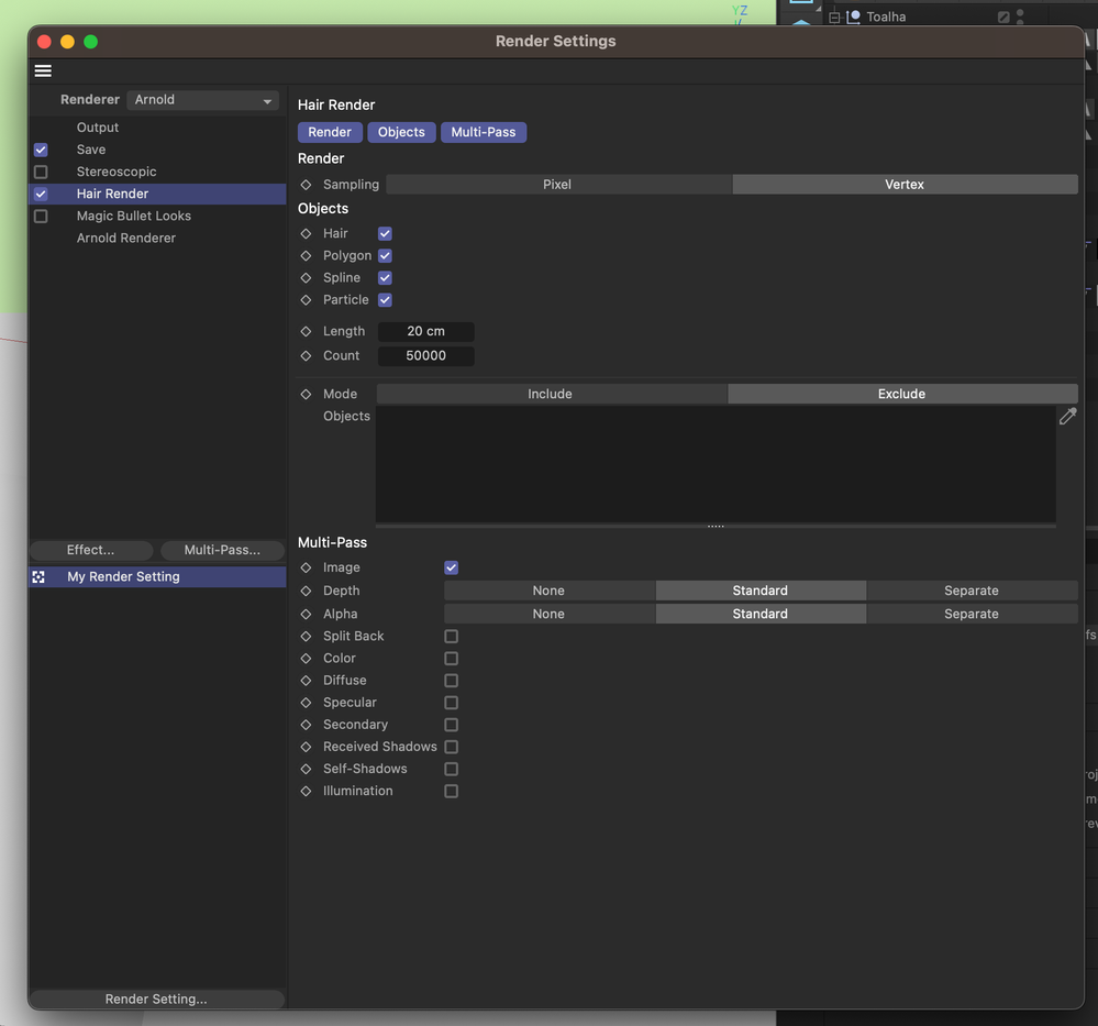

I'm trying render a towel with a brand mark applied in a hair material. Something I can see the render in IPR, other times is not working anymore but, in the picture viewer, Arnold is not render the color information.

You find a "Render via Hair Render effect" option under the Advanced tab in the Arnold hair tag. Does it help if you check that? If not, can you share your scene I could take a look at?

It was already checked. I've tried to uncheck but is not working either. Here's the file.
