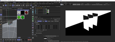

I have issues with a glass rendering with transparency.
I need it later with transparency/ alpha for photoshop, preferably with shadow and reflection.
The following problems:
- If I set all lights with transmission 0, I get a bad result. I despair at the light source, does anyone have ideas?
- I have set the plane for shadow and reflection to zero in the camera, otherwise I will lose transparency again. But I can't get the shadow and reflection that way.
It's probably quite simple, but I'm going round in circles...
This is how the lighting appears:
But the colours should look like this:
I hope someone can help me.

Are you using standard_surface.transmit_aovs?

Hi Lee, thank you for your reply. Transmit AOV in the materials ist enabled and the Arnold Skydome and Arnold Sky ist set to 0 in Transmission. I´m slowly getting there with changing the material settings. The big question is now, can I get a shadow out of a plane with shadow_matte and without losing all my light (which happened already when I tried...)?

The shadow_mate isn't giving you a shadow? Is transmission_weight for the glass at 1?
Can you upload the scene?

Hi Lee, the shadow matte is giving me no shadow and is also deleting my transparency in the alpha.
I must be missing something. Here is a test file. I converted it to 3ds (I didn´t know that I can´t upload c4d files), I hope it works.

I see a shadow when I add an HDR map to the skydome_light.color. This is with a new shadow_matte shader assigned to the plane.

Thin_walled was enabled. It should only be enabled for single-sided geometry without any thickness. Also, your IOR was 0. It should be 1.5 for glass. These might be what is causing you issues.
Here is the scene. You will need to replace the HDR map with one of your own.

Thank you Lee! I took your file  and put in my own HDR texture.
I have a shadow but my glasses are not transparent/translucent:
Do you also have a solution to render the shadow on an extra layer with multi-pass?

You can't see an alpha for the cubes because the plane is in the way. If I move the plane to one side you can see the glass alpha.
Also, the skydome light is visible in the transmission of the cube. If you reduce it to zero you can see the alpha for the cubes.

My mistake was that I thought the shadow_matte makes the plane completely invisible!
I learned:
To solve my problem I must do one rendering only with the glasses and alpha and another rendering with the shadow from shadow_matte and put them together in Photoshop.
