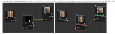

1.The original function is missing.The latest version does not work.
2.It is not smooth when adjusting the roughness and color correction nodes, and the experience of the latest version is not as good as the version before 4.3.0
I found these problems temporarily,Maybe I used it in the wrong way.
