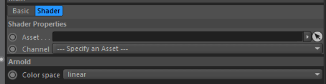

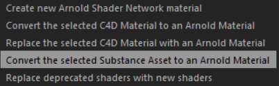

Hi guys, as the question suggests, I have problem when I convert a substance asset to arnold material.
I use the built-in convert command to do the work, as the pic shows
Then when I opened the network editor, every asset slot of substance shader node is blank.
Actually I use substance assets very rarely, so I am not sure if I was doing anything wrong.
But how can I fix this?

You have to create the substance shader first (eg drag a Substance file to the Asset box) and the select a channel.
Then you can convert Substance to an Arnold Material

peter.horvath6V6K3
Well, actually there's a bug in the two latest versions (2.4.3 and 2.4.4), which I just fixed today. So the upcoming 2.4.5 will have the fix.

Aaron_D1
Thanks for the answer. Of course I know how to convert this in a manual way. But I am looking for the automated way, because my producer gave me tons of substance assets to convert. Doing this one by one manually might be kind of pain. However, it seems that I have to do this manually before the fixed version is released.

peter.horvath6V6K3
I'll make you a wip build in sec, so you don't have to relink the assets manually.

peter.horvath6V6K3
Well, it was more than a sec, but here you go. 🙂
https://safeshare.solidangle.com/index.php/s/uKec5tdoZDH7xpX
