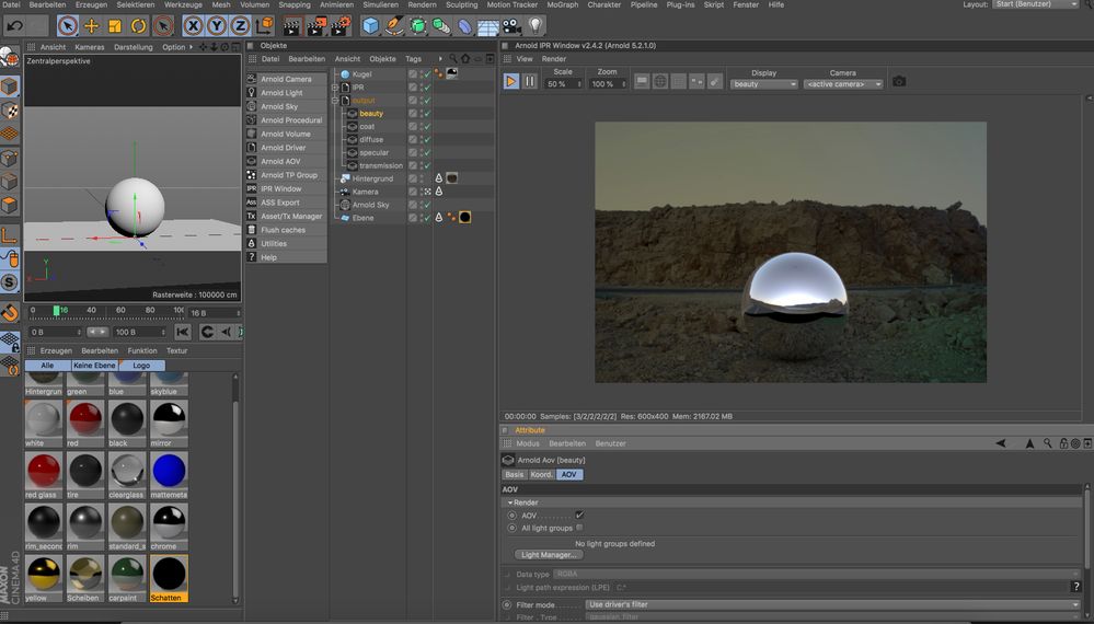

I built this simple scene to show my problem. I want to render this glossy sphere with a background image and a shadow matte. I render to the output_exr.

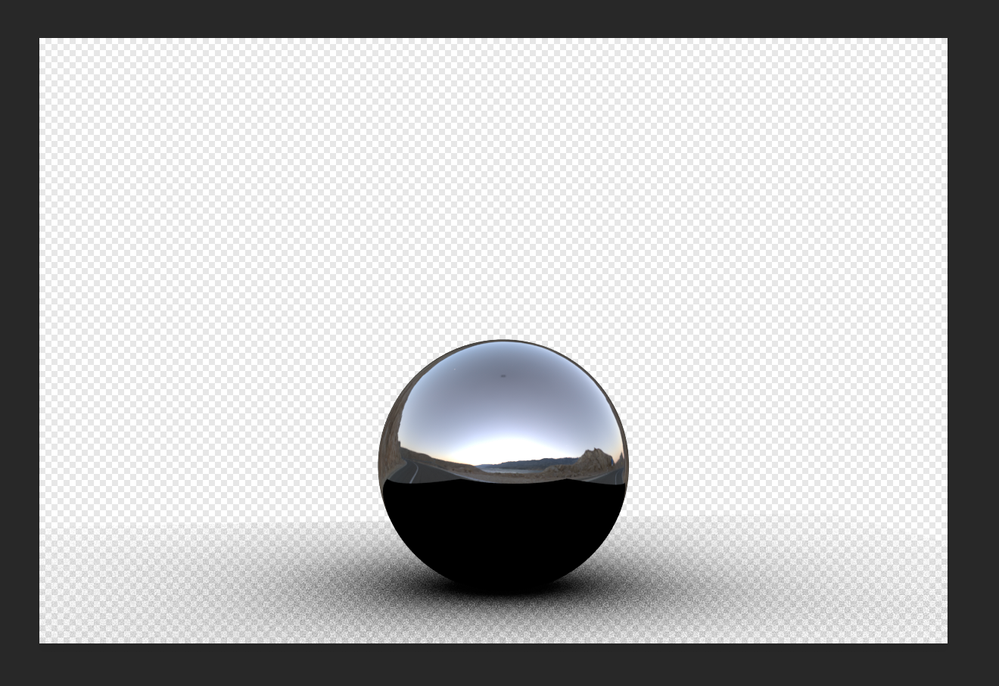

In photoshop it looks like this. How can i render this with transparency at the area of the background??
I don't use the RGBA but the other 4 channels so its black.
2621-bildschirmfoto-2018-11-06-um-231437.pngWhen i switch off the background for rendering its of course transparent but also missing in the reflection in the sphere.2620-bildschirmfoto-2018-11-06-um-215713.png
I would be very happy to get a solution for this or maybe i do something wrong?
I just render stills and compose 3d on the background in PS later.
Arnold v2.4.2
C4d R20.026

If I understand correctly what you need is to get rid of the alpha of the background, right? That's the alpha channel of the image, so you can for instance add a color_correct shader and multiply the alpha by 0.
