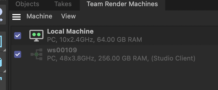

So I can run the trial on my Mac M1 C4D R25 and Team Render it to my PC? If so I have problems, The PC is greyed out in the Team Renderer. The Firewall is off.
And this is how the Team Render looks.
Can't seem to get that to work ether.
