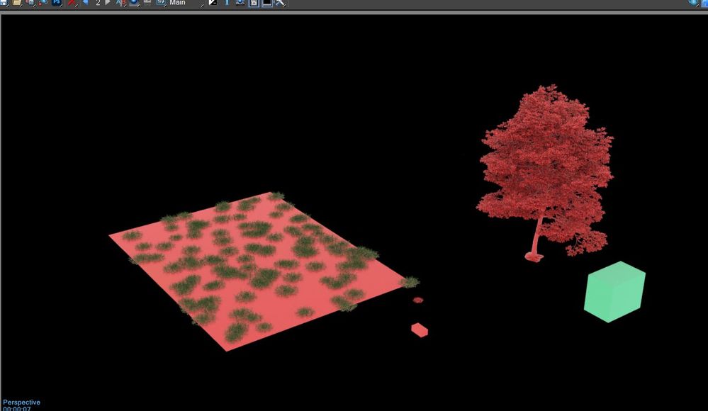

A couple of issues with this setup.
Sometimes the ARV doesn't respect the operator. The image bellow shows that
But if I render it kind of works. Box002 isn't rendered with the material, but at the same time, Forest Pack gets ignored. Forest Pack and the geometry that is been scattered have unique names.
Could this be a bug?
Here is the scene
https://we.tl/t-evhD2ukVfi
If you want to have a go.

Message 12 of 28
Stephen.Blair
I'll take a look.
In the second screenshot, what is the expected result? The instances on the plane should be "red" ?
// Stephen Blair
// Arnold Renderer Support
Message 13 of 28
CiroCardoso3v
Thanks Stephen. On the second screenshot the result should be seeing the green box only and everything else is red. I have a gif that shows the issue. Give me a second and I will upload it

Stephen.Blair
Hi @Ciro
You'll need to test for ginstance nodes too. They have shaders applied to them too, and that overrides whatever shader is applied to the original polymesh.
*.((@node=='polymesh' or @node=='ginstance') and not (name== '/Box002'))
