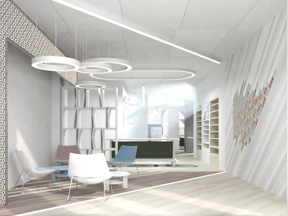

I have a lot of complaints from my partners that my final renderings are not producing shadows. In this rendering I don't use any quad light or spot light. I only use mesh lights, means that where you see lamps, these are objects assigned as meshes to mesh lights.
If you notice down the image, the chairs and the table are not capturing shadows over the floor. I keep all mesh lights values low (illumination=1 and exposure=1) and also I keep low the global exposure (environment dialog) with a value of 2.0 EV.
Do I have to stop using mesh lights and using normar arnold lights like spotlights ecc or is it something else?
thanks for any answers.

The mesh lights are fine.
Your image is extremly flat meaning middle tones are completly dominating, so you lack contrast, and that is what shadows versus highlights are.
In post you can simply raise the blacks significantly and dial back the middle as well to gain even more contrast, which will bring out all shadows in return.
So you need to work with the final render and make it "pop" after rendering is done.
I made an example here, lowered the overall lightning a nodge but greatly increased the contrast.
In general you use the "levels" filter, and in general you move the 2 most left flags to the right.
You need to play with it and you need to be way more agressive on grading than you think you need to, to lift it out of the pale and uncontrasty environment that, atleast for this image compeltly dominates the feel.
This way all shadows steps into character and all transitions between shadow and middle are more clear.
While doing this on a test, you may find your post correction sits nice, but some surface some specific place becomes to dark, this is where you either use a mask to feed the surface back, or simply just lighten it in the render application and rerender a final.
As for lack of shadows under chairs, well, your lightning dictates it, so you could for example just lower external light, or increase the artificial lights and lower exposure to create more scene contrast and less "everything is evenly lit" nothing is never ever evenly lit in the real world. It is full of blown out highlights and crushed blacks.
Also considder how you light the set, it looks like there is light coming from behind the camera, that will blow out any shadows under the chairs for sure, light fixtures can be incorrectly modelled giving a much more omnious and less directional light than the real one, I dont know, but check up on that.
So you need to balance it out a bit better with light intensities in the render, and then crank the blacks up in post.

Mads you know I test and apply all your advices... So I will read carefully your answer and see how to improve my renders with post.
But still I cannot understand why the chairs have no light on the floor and I have plenty of lights (mesh lights) 😞

As I mentioned, your artificial lights that you want to use to create hard shadows on the floor are blown out by some general lightning, if you turn off all lights and just let the long lamp be the only one giving light you work in the intensity from there, its too vauge.
Message 5 of 14
madsd
in reply to: pproestos

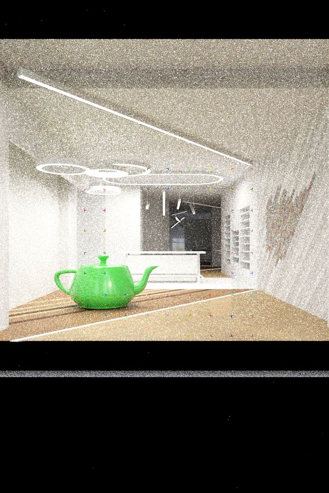

Look here. I illustrate your problem. You have too much ambient light going in the room, I enable a skylight to show you the effect of having too much ambient light going in a room at the cost of loss of contrast and more importantly in your case, loss of shadows, they are washed out completly.
Your lights are sending out too omnious light and you need to control them
All your lamps contribute too much to over all lightning and it will blow out shadows instantly if you get so much light from all angles.
https://imgur.com/a/5qdrlJo
Also it looks like there is a skylight or some huge window behind the camera, contributing to a ton of light, that light will instantly wash away any weak light, and your long and circular lights are very weak.
Simply put you got way too much light bouncing around in the room.

Try close all lamps down, everything, all of them, zero.
Then enable the long rectangle, and you will see super shadows under chairs instantly.
They get gradually washed out because you keep adding in lights in the same spectrum, so they all compete with each other, in the same area of the light band.
There are no strong and weak lamps, they all sit and emit the same amount of light.
Now pair that with lack of crushed blacks and nice highlights and you got the recipe for a bland and uniform non contrasty image, you need to work on several parameters and you need to understand that the more lights you add in, the less sharp shadows you will get if they are too weak, and you compensate by raising some general exposure, or worst of all, mid tones way up "to try make the image brighter"

Then turn the big lamp down in a seperate setup so they dont share same intensity as the rectangle, and color the lamp pure white with emission 1.0.
Dial them in till they sit nice with the first light, because yes, that is far better contrast is much better on first image. But you can use mesh light fine, just turn down the big one.
Now, only dial in the big ring, remember its a much larger surface so if you power the same through as on the rectangle, you get too much light, just a little bit, watch the shadows when you render a rectangular shape in active shade, where you also have some of the wall in the rectangle so you dont over do their power.
Just phase them in from 0, give solid color first on emission so its always white, then slightly increace wwith the spinner and render window updates fast with right settings.
Be gentle with the big light, it very easily overpower the long rectangle, and we have to remember the mission, your partner wanted nice shadows under the teapot, so dont kill them with the big ceeling lamp giving it the same output as the rectangle, less is more.
2 different setups for the 2 mesh lights in the ceeling. 2 different exposures, you would want to add supportive light to your master light, which is the one giving nice shadows on chairs. Now, all other lights are just supportive lights. meaning they come in from below and stop some place where they dont destroy main focus point, which are chair shadows. Workng like this you can quickly create small stories here and there in images on request and you get some training in setting up custom focus points.
