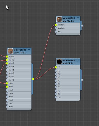

MAXtoA expects two shader connections:
  • The first is for the fluid
  • A second for the foam
If you plug a Layer Shader into the first slot of a Multi/Sub-Object (or a Mix shader), then that Layer Shader is used for the fluid.

> I don't see why a Multi/Sub-Object Material would be relevant to assigning a
> Layer Shader to the fluid. There are no foam particles in my simulation.
Whatever shader is assigned to the fluid, the first connected shader will be used for fluids, the second for foam.
You have a layer shader connected, so the first connected shader is used.
So if you want to use a layer shader for fluids, set up a shader tree like this (you can use either a Mix shader or the Multi/Sub-Object Material)

Thank you Stephen, I will try that. But I'm scratching my head because this is just not right. The Layer Shader functionality should be completely independent of the Multi/Sub-object functionality. There should be no mapping of Layer Shader inputs to Material IDs. In other words, everything going through the Layer Shader should go to Material ID #1. To my understanding, Layer Shaders is not a tool for routing materials to different Material IDs. It is supposed to be a compositing tool that performs masking operations independent of any consideration of Material ID.
This is definitely a problem. And since it is also occurring with the 3ds Max legacy Blend node, it may be a problem that transcends Arnold, and something that needs to be addressed by the Max team.
Message 11 of 11
aaronfross
Confirmed, thank you Stephen. I've logged this as a bug:
